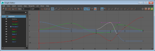

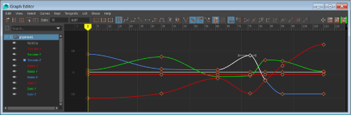

Graph Editor UI
Switch between the Classic or Modern User Interface.
Note: You must close and reopen the Graph Editor for these changes to take effect.
Classic Graph Editor UI
See Classic Graph Editor for menus and features associated with the Classic Graph Editor UI.
Modern Graph Editor UI
See for menus and features associated with the updated Graph Editor UI.
