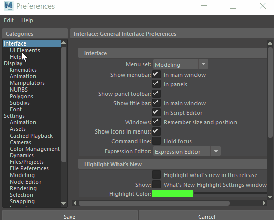

Preferences window
In the Preferences window you can set preferences for many functional elements of Maya LT, organized by different categories.
Open the Preferences window and click the categories on the left side to show the settings.
You can also click the Animation Preferences icon in the lower-right corner of the Maya LT window. This opens the Preferences window to the Time Slider category, but you can then select any category you like.
