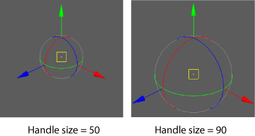

Handle size
Specifies the size of the handle. The range is from 4 to 100.

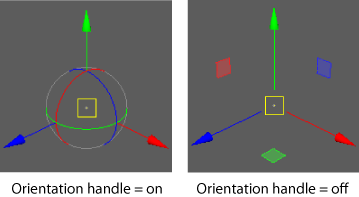

Orientation handle
Controls the visibility of the orientation handles. The orientation handles are turned on by default.
Orientation handle size
Sets the size of the orientation handles. The default size is 50.
