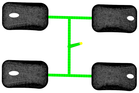

Start a Project
In this task, you create a project and import the study for this tutorial.
Download the files for this tutorial from Autodesk Knowledge Network-New User Quick Start folder.
  1. Click Start and Learn > Launch > New Project.
  2. On the new project dialog box, Enter the project name Quick Start BEM Cooling Analysis then click OK.
  3. Click (Home tab > Import panel > Import).
  4. Navigate to the location where you saved the tutorial files.
  5. Select the study mousecover_4cavity.sdy and click Open.
