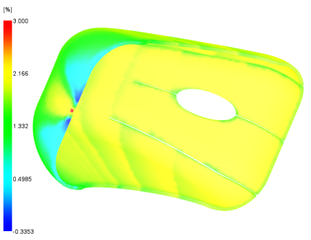

  1. Turn off all layers except the Parts layer.
  2. Click Volumetric shrinkage at ejection in the study tasks list.
  3. Rotate, pan, and zoom as necessary to see the volumetric shrinkage results.
    The volumetric shrinkage for this material is best when between 1% and 3%. The end of fill is high, and the area near the gate is negative which means significant over packing.
