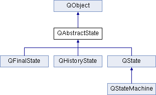

+ Inheritance diagram for QAbstractState:

Reimplemented in QStateMachine, QState, QHistoryState, and QFinalState.
