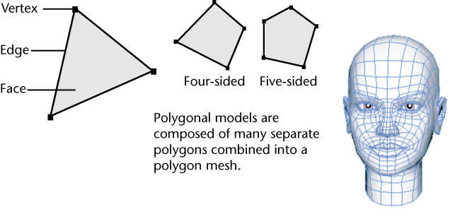

Polygons are comprised of straight-sided shapes (3 or more sides), defined by three-dimensional points (vertices) and the straight lines that connect them (edges). The interior region of the polygon is called the face. Vertices, edges, and faces are the basic components of polygons.
Many faces connected together create a network of faces called a polygonal mesh (also referred to as a polyset, polygonal object, or polygonal model). Polygonal meshes can be created in many 3D software applications (3ds Max, Maya, StudioTools, and so on), then exported for use within Mudbox.
