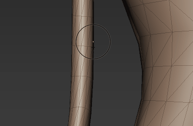

Grab Silhouette
Specific to the Grab brush. When on, the tool grabs the front and back sides of the mesh silhouette together to modify it evenly. For better control, use an orthographic view (top, side) when applying this tool.
Follow Path
Specific to the Grab brush. Makes the mesh follow the path of your stroke as you pull extensions out with a sweeping gesture. Stroke more slowly to extend the mesh further. When off, the Grab brush pulls extensions out along a straight line.
