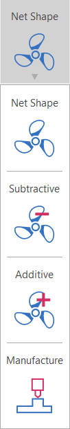

Click the Select Mode button on the Main toolbar to select a mode:
- Use the
Net Shape mode to make changes to the final design of your parts.
- Use the
Subtractive mode to add extra material to parts which can be removed by subtractive machining.
- Use the
Additive mode to prepare parts for printing.
- Use the
Manufacture mode to export parts and data for manufacturing.
The tools available depend on what mode is selected.
