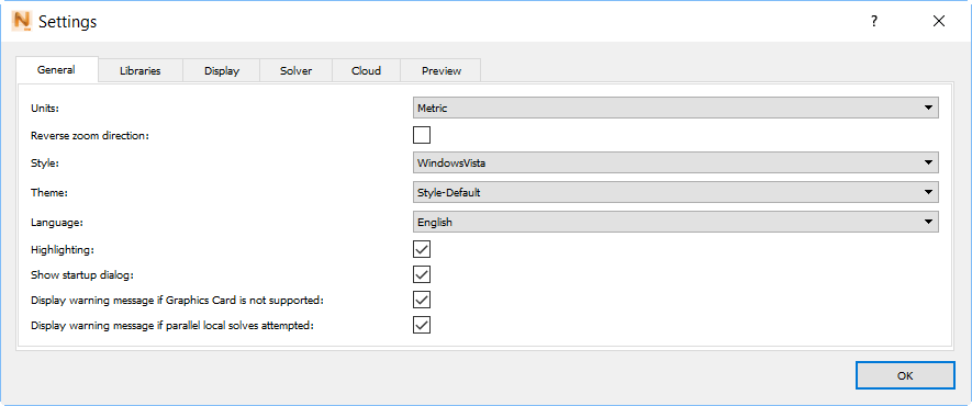

General tab
- Units – Change the system of units if desired. The solver system of units, Metric (kg/mm/s), SI (kg/m/s), or US-English systems of units (lb/in/hr) is defined on the
Units reference page. If you have an open project and change the units here, the units will change throughout the dialogs and displays, such as in the Heat Treatment temperatures and the Browser display of hot spots and lack of fusion. For temperatures, the Metric option uses Celsius, SI uses Kelvin, and US-English uses Fahrenheit.
- Reverse zoom direction – by default scrolling the mouse wheel towards your hand zooms out. Checking this box reverses this.
- Style,
Theme, and
Highlighting control the visual appearance of the user interface. The Style settings enable you to replicate common appearances such as Motif and Windows XP.
- Language – Select the language to be used in the user interface. You will need to restart
Simulation Utility to see the effect of a language change.
- Show startup dialog – by default this option is checked, which brings up the splash screen upon startup.

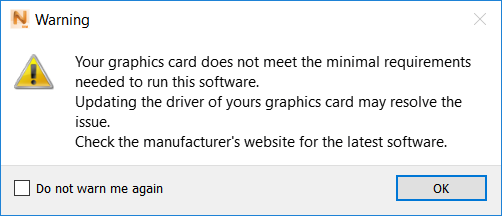

- Display warning message if Graphics Card is not supported – Select this if you want
Simulation Utility to check the graphics card on the computer, and display the following warning message if it is not supported:

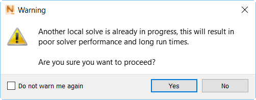

- Display warning message if parallel local solves attempted – Select this option if you want users to see the following warning message if they start another solve while one is already running:

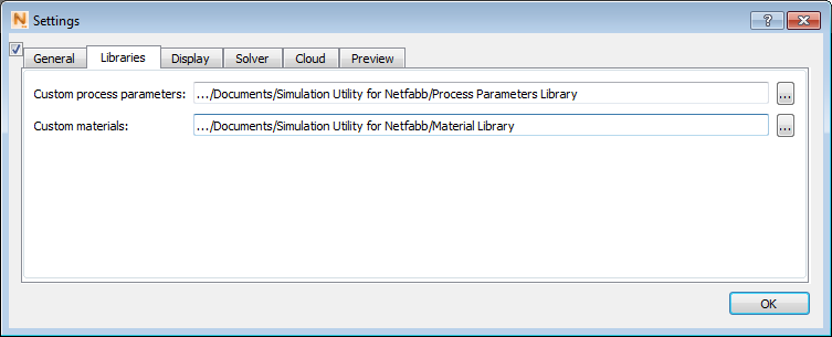

Libraries tab
Shows the current path to the libraries of process parameter (PRM) files and physical materials. You can change these paths if required. On a Windows computer, the default location for both libraries is
C:/Users/<user name>/Documents/Simulation Utility for Netfabb
Warning: After generating, scaling, or importing custom PRM files, or adding materials to the repository, changing the location of the processing parameters or materials library will remove the custom PRM files or material properties.

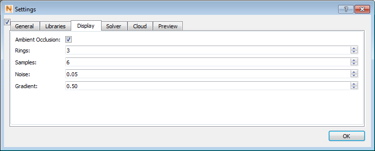

Display tab
Allows you to adjust Ambient Occlusion settings for improved rendering of parts.

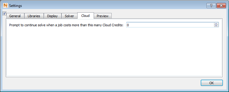

Cloud tab
Used to set a value that applies when you run simulations on the Cloud rather than on a local computer. If a job costs more Cloud Credits that the value entered here, you will be prompted to approve the cost.

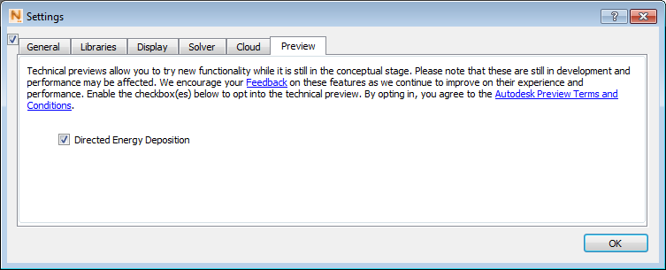

Preview tab
If present, this tab allows you to enable new functionality that is under development in the product. In so doing, you are invited to submit comments to the developers about your experience with the new features. These functions are only available for users with a licensed version of
Autodesk Netfabb Local Simulation.
