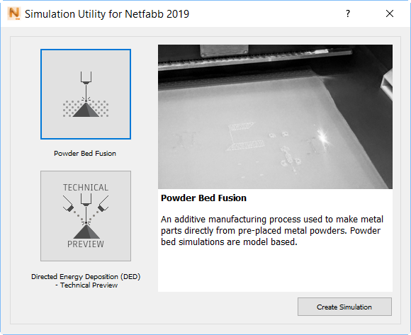

To create a new simulation
- Select New. The following dialog appears.
- Click the type of simulation you are preparing, Powder Bed Fusion or Directed Energy Deposition (DED), then click Create Simulation.
Note: If you are running
Simulation Utility LT, the DED option is not available.
Depending on the simulation type chosen, a standard Windows Open dialog will require the importation of a model file:
- Powder Bed Fusion - import an STL file or any of
14 other supported file types.
- DED - import a
Laser Vector (LSR) file
