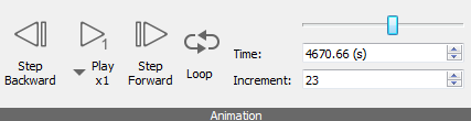

Click Play  to see a looping animation of the simulation results, with color changes to indicate the extent of displacement or temperature change as the part is built. On a drop-down menu, you can select x2, x4 or x8 to increase the play speed by multiples. Click Loop to repeat the animation over and over; click Play again at any time to stop the action.
On the time slider, you can click and drag the marker to review specific parts of the animation, or use the Step Forward and Step Backward arrows to move one index at a time.
The Time entry shows the time associated with the current increment. The up and down arrows may be used to step through the time steps.
The Increment entry shows the current increment number. The up and down arrows may be used to step through the increments, or a select increment can be jumped to by typing it into the Increment field and pressing enter.

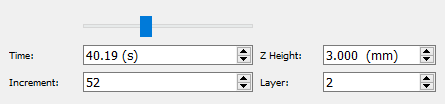

If you are reviewing the animation of a directed energy deposition (DED) simulation, additional controls are available for you to display a specific Layer number or Z height.
When you select a Layer number or Z height value, the standard controls for Time and Increment adjust accordingly.
