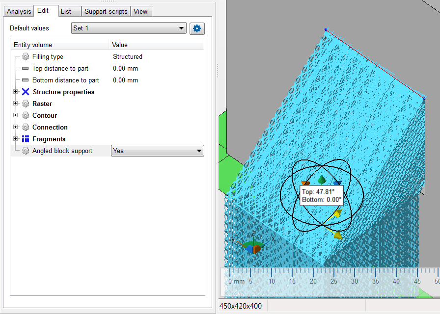

Adjust the direction in which generated volume supports are projected
Volume supports are always projected vertically. This may not always be desired. For instance, the projected support may hit sections of the same or of another part which is not wanted. Or, maybe that is explicitly wanted, but it currently doesn't. For those cases, a knee-like angle may be added to such structure to make it deflect as needed.
Angle support to make it run clear of part sections below the supported area
