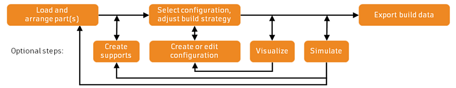

Metal Workspaces – SLM, SLA, DED
The greatest advantage of the metal workspaces is the interconnectivity with Autodesk® Simulation Utility for Netfabb®. Before the project is actually manufactured, a large number of decisions can be made from the information gained from simulating the build process. Simulation can outright replace the original part, for instance, when thermal and mechanical effects must be compensated for by manufacturing an intentionally deformed part that reaches the desired shape only after cooling.

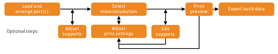

Resin Workspaces, Extrusion Workspaces – SLA, FFF
