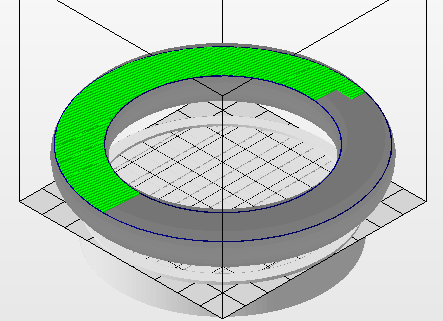

Once generated, the toolpath and its visualization becomes available for examination in the Preview. The controls in the context view change to adjust the toolpath display and its playback.

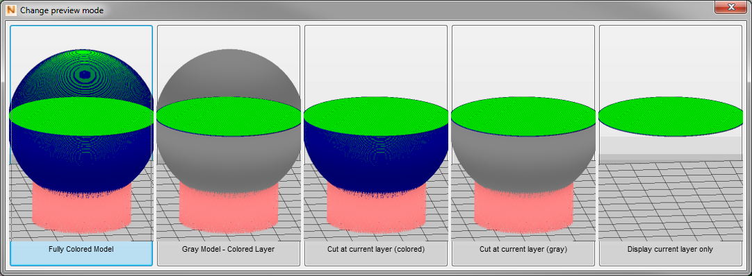

Mode allows you to select how the part and layers are displayed.
Switch between preview modes to get the best insight into the rendered toolpath.

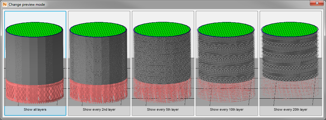

Layers provides a selection between rendering all layers, or every second, fifth, tenth, or twentieth layer.

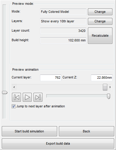

The Recalculate button is used to update the preview of the part each time you change the layersize setting in case you canceled the preview calculation earlier. Otherwise, changing the selection in any of the above updates the toolpath and visualization automatically.
This section also displays the layer count and the build height for your information.
The build information reports details about the layer count, the build height, the current layer, and the current z height. The current layer and the current z height are updated as you use the scroll bar to visualize the different layers of the build.
The Preview animation section provides information and playback controls to run and control the playback of the toolpath visualization as it progresses through layers and its contours and hatches. You can navigate slice by slice and adjust the playback speed, for example, and watch the same layer build-up repeatedly by unchecking Jump to next layer after animation.
