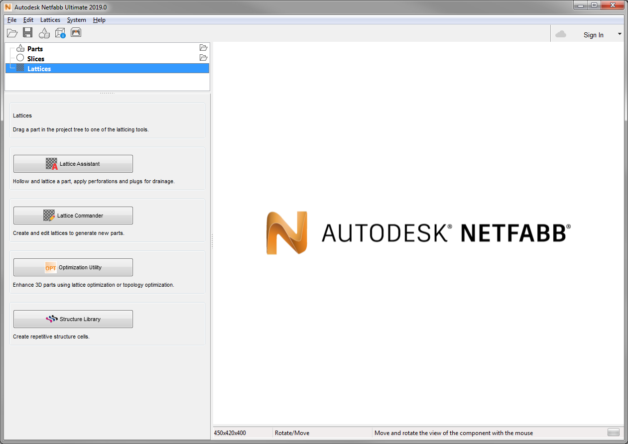

Convenient access to the latticing tools in
Netfabb is provided through the
Lattices section in the project tree. Select it to find buttons to the four main latticing tools in the context view.
