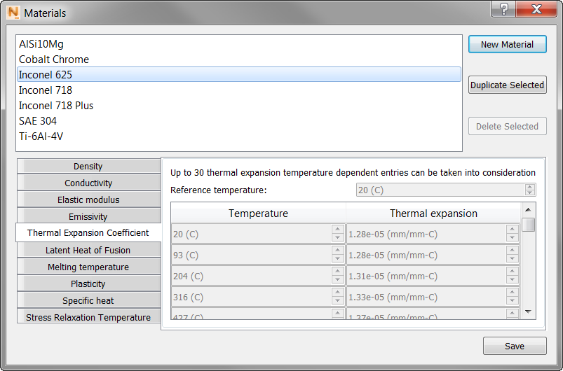

Click to manage the materials in the library. Users can create new materials, delete unwanted ones, and copy a material to use as a basis for defining a new one.
When creating a new material, first specify the name, and then the various physical properties in the chosen system of units. To change the system of units shown here, go to the
, and open the
Units drop-down menu.

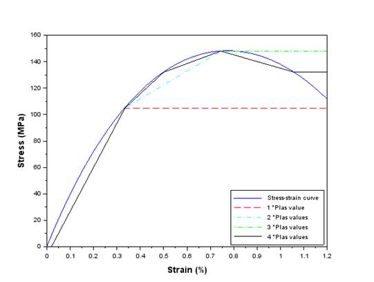

- Plasticity - Up to 5 pairs of stress-strain points can be used to describe the plasticity curve of the material at each temperature. Perfect plasticity is assumed after the final plasticity point at each temperature. Every temperature must use the same number of points. To enter the plasticity curve, specify the temperature, stress, and strain. Points with the same temperature will describe the yielding behavior at that temperature. For example using 3 points to describe the yielding behavior of a metal would look like this:
Different approaches for approximating the plasticity curve are shown in the figure below:
Using more points allows for a closer approximation of real material behavior, but can increased the computational time during moving source simulations, PRM generation, and models that enable
