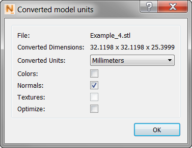

  5. In the Converted model units dialog, ensure that Converted Units are Millimeters and Colors is not selected, then click OK.

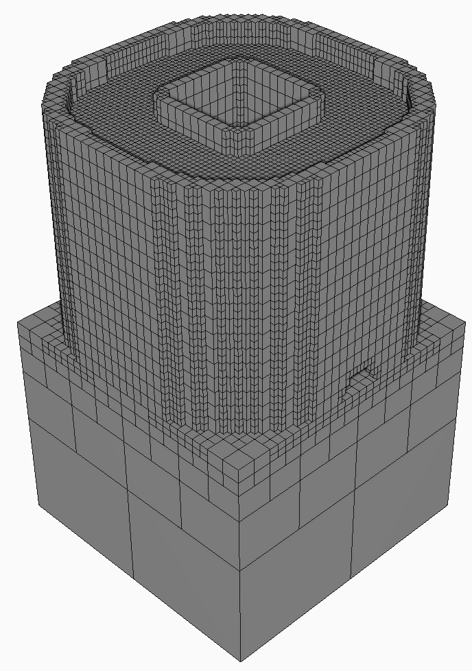

  8. Click Home tab > Mesh Preview and you are prompted to confirm the file name and location. Change these if you wish. When you click Save, the mesh generation begins.
  9. When the analysis is completed, load the results to see the mesh.

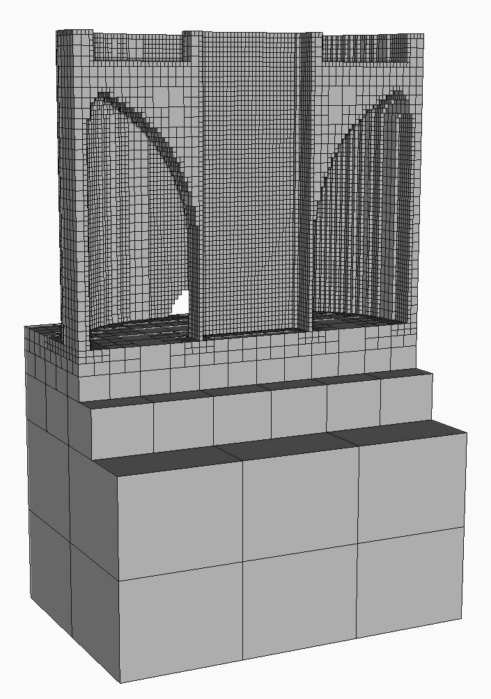

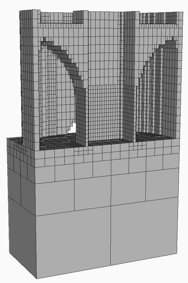

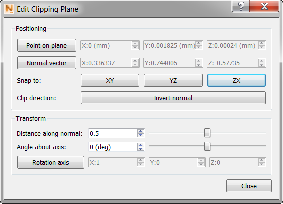

  10. Click View tab > Clipping .
  11. In the Edit Clipping Plane dialog, click Snap to: ZX or one of the other axes combinations to get a good cross-section view of the mesh.
    If the cross section is facing away from you, click Invert Normal to see it correctly.
  12. Close the Edit Clipping Plane dialog to more clearly see the clipped object.
    Note that the outside wall of the part has a width of one voxel. As a general rule choose mesh settings that create at least 2 elements through the thinnest feature of interest, so that the part can distort freely, without artificial stiffening.

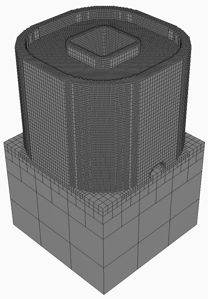

  13. Return to the Home tab > Mesh Settings and set Coarsening generations to 1 and Layers per element to 10.
  14. To generate a new mesh, click Home tab > Mesh Preview, and choose to invalidate existing results.
    This time you should see a mesh that is noticeably finer in resolution.
  15. To examine the cross-section details, click View tab > Clipping again.
    Now the outside wall should have two elements through the cross section. Note also that the resolution of the mesh varies by region. Critical areas of the part, such as curves, are rendered with small voxels, while the inside of the build plate uses larger elements, with hanging or constrained nodes. This adaptive mesh resolution allows Simulation Utility to generate both preview meshes and full simulations very quickly.
