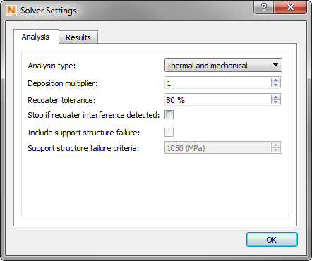

The deposition multiplier can be set to an integer value of 2 or higher to simulate the building of multiple copies of a part on the build plate. So a setting of 4 would simulate building 4 copies of the part, and extend the build time accordingly. In practice, this multiplier is often set to account for the building of multiple parts, even if the parts are not identical, just to get an approximate time measurement.

  3. Click Home tab > Solver Settings > Analysis tab.
    Note that Deposition multiplier has a default value of 1. This means that the simulation will account for only the part or parts on the build plate. We will first solve the simulation with this setting.

  6. Go back to Home tab > Solver Settings > Analysis tab and change the Deposition multiplier setting to 4. The simulation will account for the building of 4 parts on the build plate, and extend the timeline accordingly.
