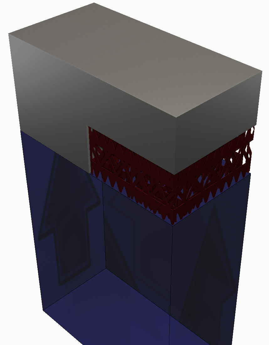

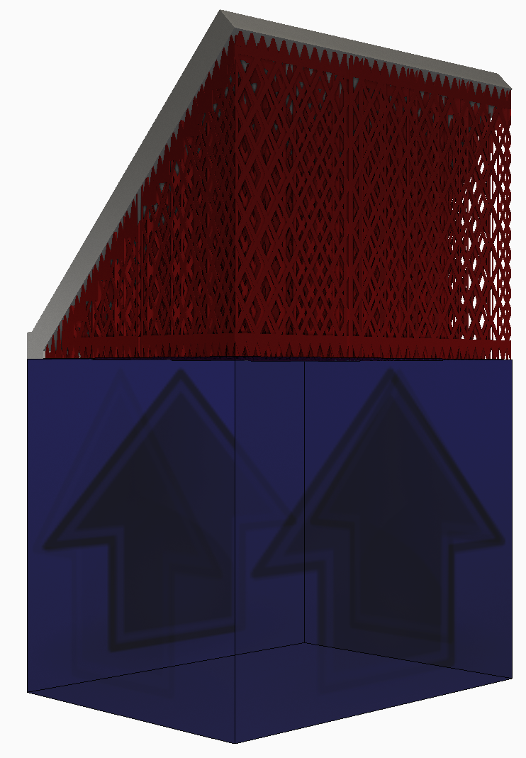

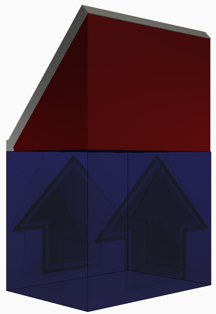

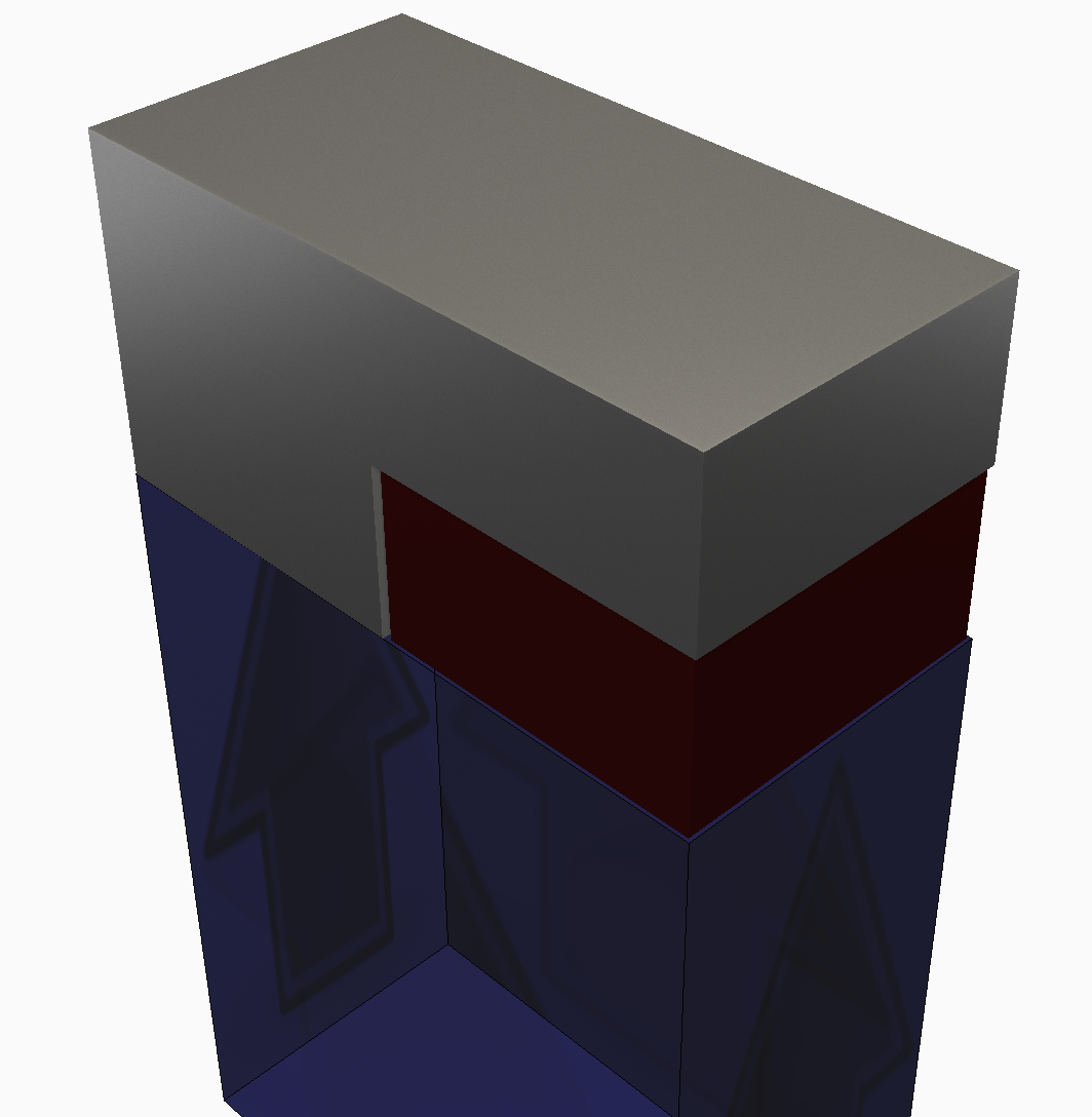

Non-Homogenized versus Homogenized support structures
As shown below, while a fine, lattice type support structure with a thickness can be meshed and run, it is advised users implement the homogenization technique to reduce memory usage and simulation time. By default, upon import support structures are colored red.
Non homogenized support structure Homogenized support structure
Has material thickness Has material thickness
Meshable Meshable
Requires very fine mesh settings Can use very coarse mesh settings
High memory consumption Low memory consumption
Slower simulation Faster simulation

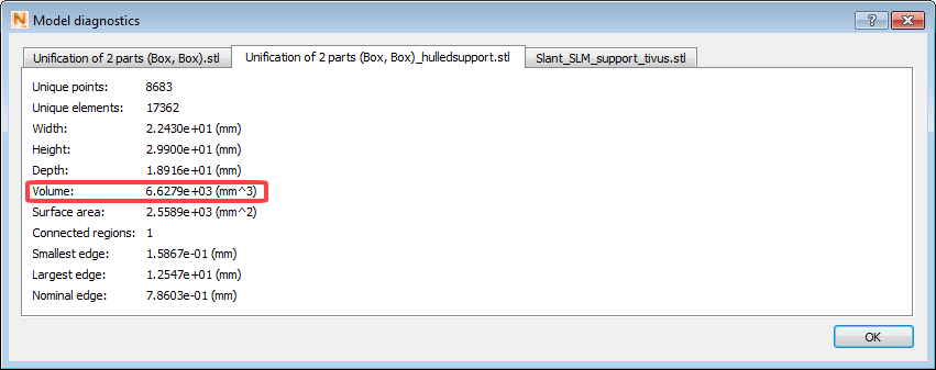

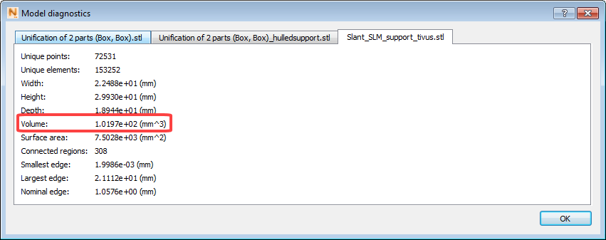

  2. Determine the volume of the original support structure. If the part has been imported into Simulation Utility, this can be found by navigating to the file tree, right clicking on the part and choosing Diagnostics from the drop-down menu. If there are multiple parts imported, select the tab corresponding to the correct part.
  3. Recreate the support structure but as a volumetric support structure, so that the support is a solid volume which occupies the same bounds as the original support.
  4. Determine the volume of the volumetric support structure.
  5. Calculate the volume fraction: Volume fraction = Volume of original support structure/Volume of volumetric support. For this example the original volume is 102 mm³ and the homogenized support is 6630 mm³, which yields a volume fraction 0.0154.
