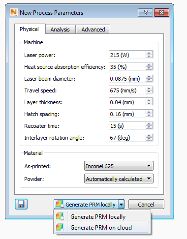

Generating Processing Parameter (PRM) files on the Cloud
To generate PRM files using the cloud:
  1. On the Home tab, click Processing Parameters and in the dialog, click for a new PRM file.
  2. On the Physical and Analysis tabs, choose the processing conditions, material properties, and analysis settings. Select both Stress and distortion, and Hotspots and lack of fusion on the Analysis tab. This combined type of PRM file can be created on the cloud. Consult the Processing Parameters topic for further details.
  3. At the bottom of the dialog, open the drop-down Solve menu and select Generate PRM on cloud.
  4. In the Job Manager, the status will show Estimating job cost.
  5. A dialog window will appear showing the price of the PRM simulation and asking to accept or cancel.
  6. Once accepted the PRM generation will commence. Monitor the Job Manager to follow job progress.
  7. After the PRM generation has completed, it will appear in the Processing Parameter Library and will be available for use for part scale powder bed simulations via the Machine Dialog.
