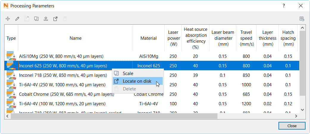

The Processing Parameters dialog allows you to manage the library of PRM files, using the right-click menu shown above, and the small icons across the top of the dialog. Left to right, the icons are used as follows:
– Create a new PRM file. Select this to create a new PRM file using custom parameters. Upon starting the PRM generation process, a PRM entry will be created in the Processing Parameters library. However the resulting PRM will not be available in the Machine Dialog until the PRM generation has completed successfully.
– Edit the selected PRM file. This allows for the easy creation of new PRM files based upon existing or failed PRM simulations. Choosing Edit will import all the Process Parameters, Material Properties, and Simulation Settings from the original PRM creation.
Note: PRM files created prior to 2019.0 will not import solver settings or material properties, so these may need to be manually adjusted. Editing a PRM from using Custom component or powder material properties will prompt the import of those properties when the Edit option is invoked.
– View the log file for a selected PRM file, if available. This command does not apply to generic, scaled, or imported PRM files.
– Create a new scaled PRM file, based on the selected PRM file.
– Import a PRM file into the library.
– Open the directory that contains the selected PRM file; same as the menu option Locate on disk.
– Delete the selected PRM file and associated files. The generic PRM files supplied with Simulation Utility cannot be deleted.
– Open the Job Manager while creating a new PRM file, to check progress. The Job Manager also provides an icon for opening the PRM log file.
