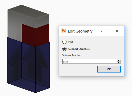

To modify the support in Simulation Utility
  1. On the Home tab, click Build Plate > Size tab.
  2. To resize the build plate, click the Snap to X and Y button.
  3. In the Browser, right-click on the support structure, which has a name that includes _hulledsupport_, and select Edit Geometry.
    Note that the Volume Fraction brought over from Netfabb was automatically calculated at 10%. Click OK. Next, generate a mesh preview to see the results of homogenization.

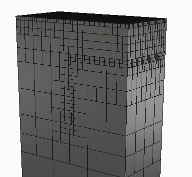

  4. On the Home tab, click Mesh Preview and save the project in a suitable location.
    Upon viewing the results observe that coarse mesh elements are used where the part and support are near the build plate, and fine elements along the interfaces between the part and support. This part will simulate in a much shorter time than if the original lattice like supports had been used, while attaining the same predictions of thermo-mechanical behavior during processing.
