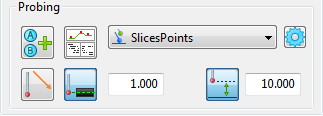

Use the Probing area of the Inspect dialog to specify the probe path used to measure a feature.
Probing strategies and methods
Probing methods are grouped by strategy. The probing strategy determines how a probe path is generated and the probing method determines the shape of the path used to probe the item. Choose a probing method from the following strategies:
AutoTouchTrigger — Generates the surface and intermediate points required to measure the item. This is the default strategy for geometric features, such as arcs, cones, cylinders, and spheres, and can be selected for inspection groups.
UserDefined — Specifies the probe path manually using the Probe Path Editor. This is the only strategy available for planes; it can be selected for other geometric features or inspection groups.
CollisionAvoidance — Generates a collision-free intermediate probe path between features on the part.
AutoScan — Creates scanning probe paths for a feature.
UserScan — Specifies the scanning probe path used to measure the selected feature.In addition, PowerInspect can select the AutoDefined probing method of Fallback when the item's original method is incompatible with the current probe or is unavailable in this version of PowerInspect. Because this method may produce a sub-optimal probe path, you should change it before measuring the part.
To view or change the parameters that control how the probe path is calculated, click the Parameters
button.
