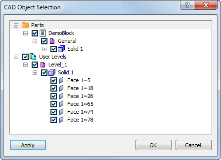

To exclude CAD levels and objects from an inspection, click Measure tab > Options panel > Active Levels.
To specify which CAD levels and objects are used in an inspection:
to expand the folders and display the CAD level and object entries.
indicates the entry is included in the inspection.
indicates the entry is excluded from the inspection.
indicates a parent level or object that contains a mix of included and excluded entries.
In this example, only Face 1~5 and Face 1~18 in Level_1 can be inspected:
