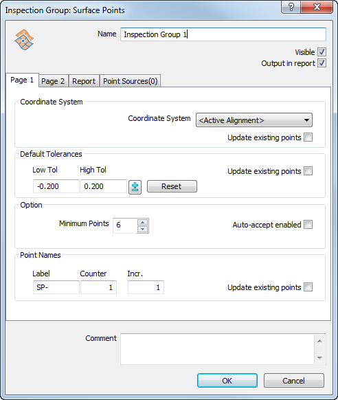

Use the Inspection Group: Surface Points dialog to specify the details of an On-the-Fly Surface Group.
To display the dialog, double-click the group's name in the Sequence Tree.
The dialog contains the following settings:
Name — Enter a name for the item. The name is used in the inspection sequence, in the Report and Info tabs, and when referencing the item in other items.
Visible — Select this check box to display the item in the CAD view.
Output in report — Select this check box to include the item in the report.
Coordinate system — Select the alignment relative to which the item's measurements are to be reported.
To specify the alignment during the inspection, select <Active Alignment>. You can then select the alignment from the Active alignment list, or by adding an Active Alignment item to the inspection sequence.
Update existing points — Select this check box to apply the selected coordinate system to items already in the group.
Default tolerances — Enter the maximum distances from the nominal surface at which points are in tolerance. Select the Update existing points check box to apply the values to points already in the group.
Select Reset to revert to the defaults specified in the Measure Parameters dialog.
Option — Enter the Minimum Points required to measure the feature. The group is treated as unmeasured until at least the specified number of points is probed. Select Auto-accept enabled to save the points as soon as you have probed the specified number of points. This setting is not available when you specify a probe path for the group.
Point names — Enter a Label, Counter, and Incr to control the naming of points added to the group. Select the Update existing points check box to apply the rules to points already in the group.
To base the labels on the name of the surface the points are projected onto, select the Use surface projected onto as point name prefix check box in the Surface Inspection page of the Options dialog.
Select the Update existing points check box to apply the changes to existing points. For example:
Comment — Enter any notes and extra information about the group.
Default offset — Enter a value if you want to compensate for surface thickness. The value can be used to compensate for the thickness of the pressing (usually a positive value), or the spark gap for an electrode (usually a negative value). The offset is applied normal to the surface at the probed point, with positive values in the direction of the probe.
Select the Update existing points check box to apply the offset to points already in the group. Select Reset to revert to the defaults specified in the Measure Parameters dialog.
