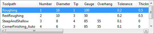

Toolpath List — Displays all the toolpaths in the NC program, together with the parameters used to create the toolpath. Select one or more of the toolpaths to display information about them in the lower half of the dialog.
You can drag and resize the columns by placing the cursor over the end of a column and dragging it to a new location.
The Number field is the Tool Number.
If the Number is surrounded by brackets, (2) it indicates that there is no tool change for this toolpath.
If the Number is preceded by an asterisk, * it indicates that Tool Number for this toolpath has been edited in the lower portion of this dialog.
If the Number is replaced by a ? it indicates that no tool number has been specified, but a Tool Numbering of As Specified has been selected.
You are not allowed to define the same Number for a tool as one that already exists for a different tool. The only time when this is not the case is when you write a separate file for each toolpath, where all default tool Numbers are 1. The first Tool Number in any file defaults to 1.

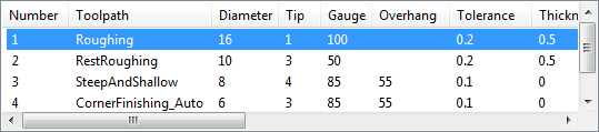

Toolpath List — Click to display the list of toolpaths and their parameters (used in the NC program) in a separate dialog.
Tool List — Click to display the list of tools and their parameters (used in the NC program) in a separate dialog.
You can right-click on the columns in the Toolpath List and Tool list dialogs to customise the view or copy data to an external application.
