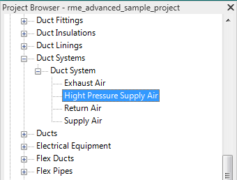

Create a custom system type for duct
  1. In the Project Browser, expand FamiliesDuct SystemsDuct System.
    Tip: To create a custom system type for piping, expand FamiliesPiping SystemsPiping System.
  2. Right-click a system type, and click Duplicate.
  3. Select the duplicate, right-click, and click Rename. Enter a name for the new system type.
    In the following example, the High Pressure Supply Air was created from the Supply Air system type and has the same system classification.
