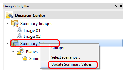

In the Decision Center, right click on Summary Values, and click Update summary values.

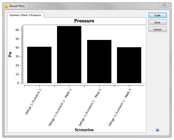

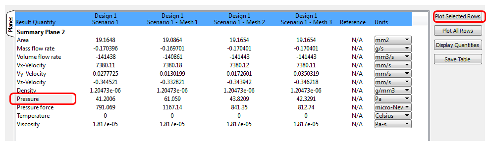

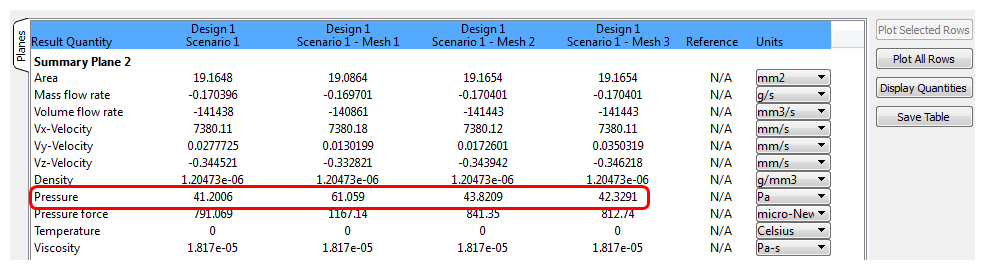

To plot the pressure from the four meshes, click on Pressure, and click the Plot Selected Rows button:
Note: Note how the pressure drop steadily decreases with each mesh refinement. The difference between Step 3 and the final mesh is much smaller than between Steps 1 and 2. This clearly shows that the pressure drop is changing less with each mesh refinement, leading toward a mesh-independent solution.
