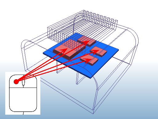

Hide the internal air.
Select the three chips and the transceiver.
Open the Materials quick edit dialog in ONE of the following ways:
- Click Edit from the toolbar:
- Click Edit from the Materials context panel:
On the Material quick edit dialog, Type = Solid.
Name = Silicon
Click Apply.
