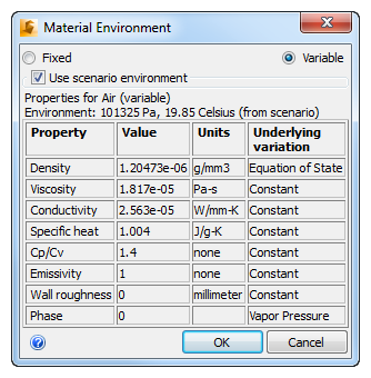

On the Material quick edit dialog, Type = Fluid
Name = Air
To allow the properties to vary with temperature, click Set... on the Environment line. On the Material Environment dialog, select Variable, and click OK.
Click Apply.
