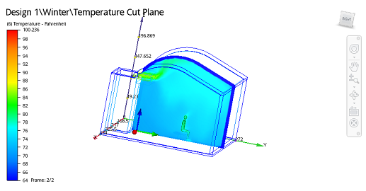

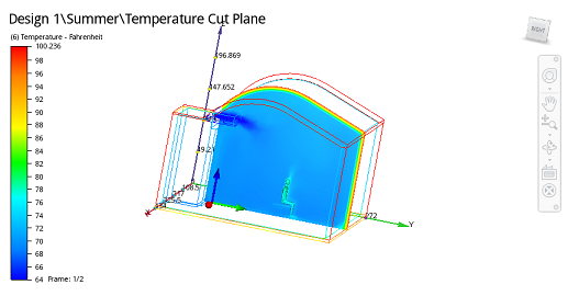

In the summer design day, the occupant's front appears fairly comfortable...
But the back is going to get pretty cold. The winter strategy, however, provides a more comfortable experience for the occupant's back:

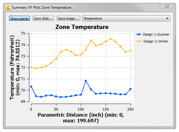

The Summary Plot showed a significant temperature gradient (nearly 2 degrees) across the occupant's body in both scenarios:

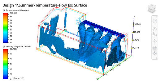

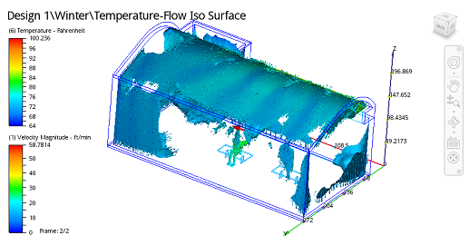

The flow results indicate a strong jet impinging on the occupant's back in the Summer scenario. In the Winter case, the flow circulates about the hall due to buoyancy before engaging the occupant:
