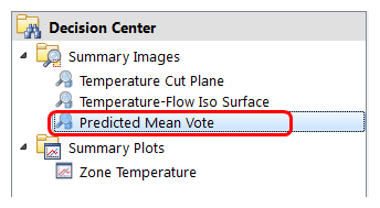

1. In the Decision Center, click Predicted Mean Vote.

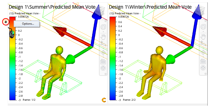

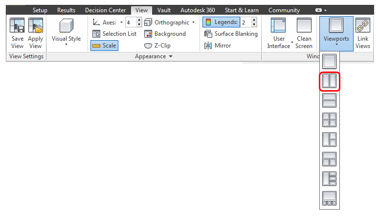

2. Split the view into two viewports. Do this by clicking View (tab) > Window (panel) > Viewports. Select the vertical split row option:

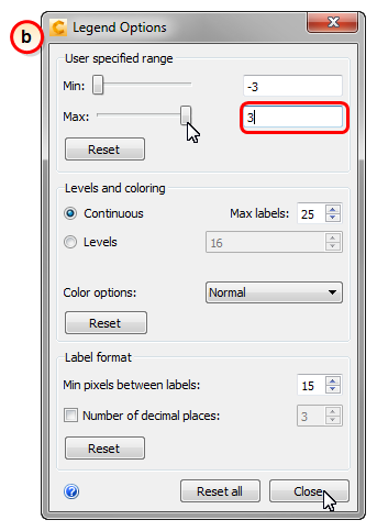

3. The default legend range automatically extends across the range of PMV values found in the scenarios of the design study. To add clarity to the Summary Image, change the range to encompass the entire PMV scale:

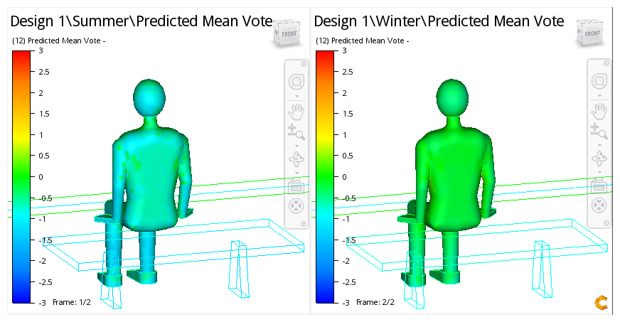

4. Zoom in and compare the PMV on the front of the occupant.

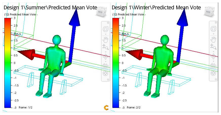

8. Rotate the model to view the PMV of the occupant's back.
