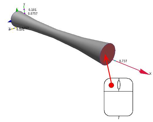

Assign Unknown Boundary Condition to Outlet
Select the outlet.
Open the Boundary Conditions quick edit dialog in ONE of the following ways:
Type = Unknown
Click Apply.
