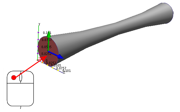

Select the inlet.

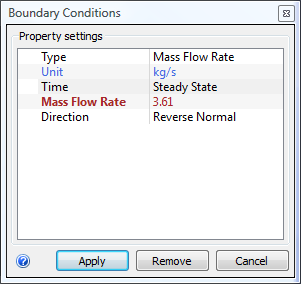

Open the Boundary Conditions quick edit dialog in ONE of the following ways:
Type = Mass Flow Rate
Unit = Kg/s
Mass Flow Rate = 3.61
Click Apply.
