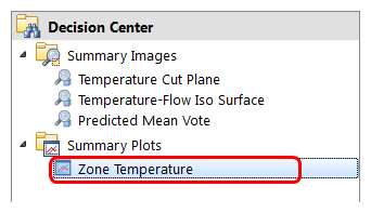

In this step, we'll use the XY Plot that we created earlier to compare the Summer and Winter temperature profiles across the upper bound of the occupied zone.
1. In the Decision Center, click on Zone Temperature.
