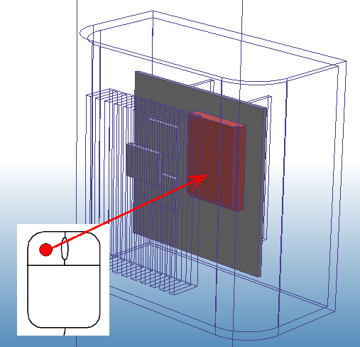

Select the transceiver.
Open the Boundary Conditions quick edit dialog in ONE of the following ways:
- Click Edit from the context toolbar:
- Click Edit from the Boundary Conditions context panel:
Type = Total Heat Generation
Units = W
Total Heat Generation = 5
Click Apply.
