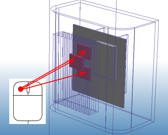

Total Heat Generation on Chips
Set the Selection Mode to Volume from the Setup tab.
Hide the outer air, the case, and the internal air.
Select the three chips.
Open the Boundary Conditions quick edit dialog in ONE of the following ways:
Type = Total Heat Generation
Units = W
Total Heat Generation = 2
Click Apply.
