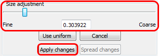

Select the house on the left.
To modify the mesh sizing, do ONE of the following:
- Click Edit from the context toolbar:
- Click Edit from the Automatic Sizing context panel:
Slide the Size Adjustment slider to 0.3.
Click Apply changes.

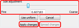

Select the house on the right.
Slide the Size Adjustment slider to 0.6.
Click Spread Changes.
Note: A slightly different adjustment is made to the two houses because the initial mesh distributions were different. The objective is to refine both houses to a similar mesh distribution. Note that it is not critical that they be exactly the same.
