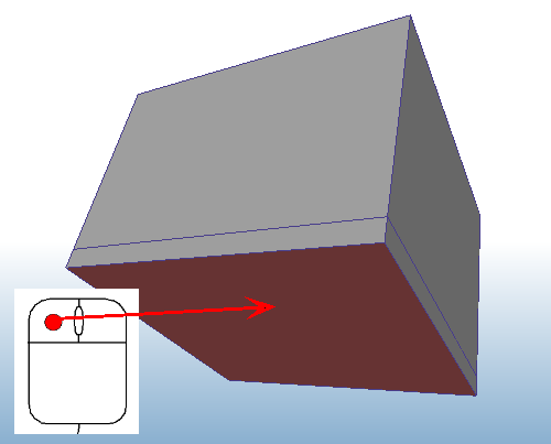

Select the bottom face of the Ground.

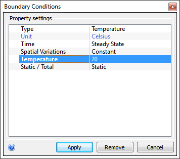

Open the Boundary Conditions quick edit dialog in ONE of the following ways:
- Click Edit from the context toolbar:
- Click Edit from the Boundary Conditions context panel:
Type = Temperature
Units = Celsius
Temperature = 20
Click Apply.
