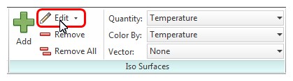

3. Click
Edit from the Iso Surfaces context panel.

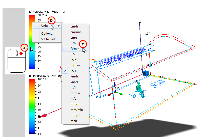

- a. Right click directly on the Velocity Magnitude legend (as shown below).
- b. Click
Units.
- c. Select
ft/min from the menu.
Note: This helps to view the velocity results using units that are a little more standard in the industry.

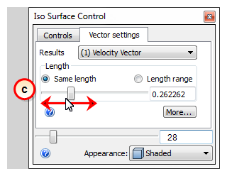

7. Display vectors on the iso surface:
- a. Click the
Vector settings tab.
- b. Select
Velocity Vector from the
Results menu.
- c. You may need to adjust the vector length to see them better. Make them bigger by dragging the
Length slider to the right; smaller by dragging to the left:
Note: The model should look like this, but may be slightly different:
Note: This is an interesting composite view into the flow behavior through the hall. The shape of the iso surface is derived from all locations in the flow that have a velocity of 28 ft/min. The vectors show the flow direction at these locations. The color shows the temperature. Notice how the cool air from the supply descends into the seating area. As the air is warmed near the walls, it rises toward the ceiling.

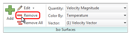

9. Because the summary image is saved, we can delete the iso surface. Click the Remove on the Iso Surfaces context panel.
Note: In this step we created an iso surface using velocity as the iso quantity and colored it with temperature results. You can also learn a lot about the thermal performance by using temperature as the iso quantity. This shows areas that are the same temperature, and are really useful for identifying temperature and airflow trends.
