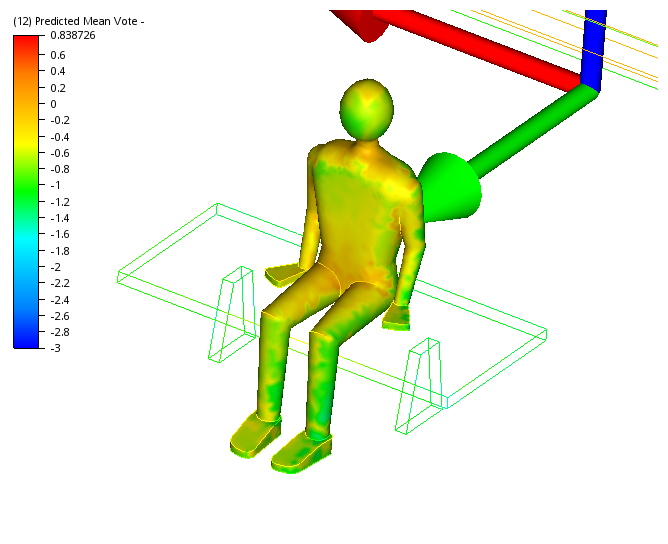

In this step, we will use the Predicted Mean Vote (PMV) to assess the impact of the design of the hall and ventilation strategy on the thermal comfort of the occupant. Autodesk® CFD calculates PMV using several factors (such as local air flow velocity, temperature, clothing, metabolic rate, humidity, and radiant heat exchange) to determine how warm or cold a person feels inside the space.

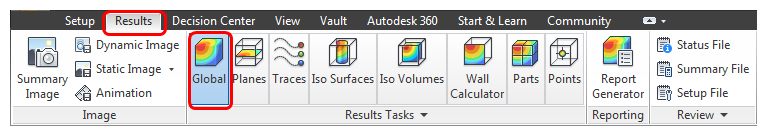

1. Verify that the occupant is displayed as shaded and that the hall is shown as an outline. If this is not the case, follow these steps:
2. Click Global from the Results tab:

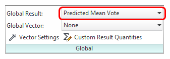

3. Change the displayed result to Predicted Mean Vote by selecting Predicted Mean Vote from the Global context panel:
Value |
Sensation |
-3 |
cold |
-2 |
cool |
-1 |
slightly cool |
0 |
neutral |
+1 |
slightly warm |
+2 |
warm |
+3 |
hot |
At first glance, our occupant doesn't seem to be in too much discomfort. We need to compare the results from the Winter scenario, so we will first capture a Summary Image...
