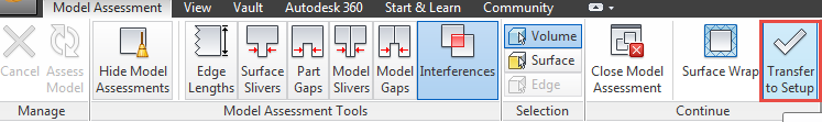

  1. Click Transfer to Setup in the ribbon.

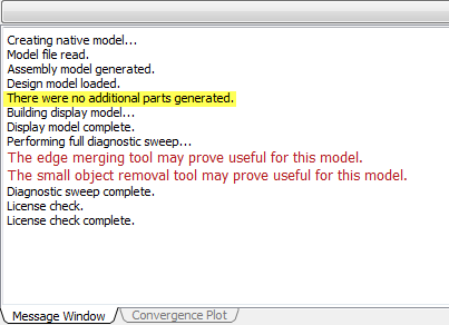

    Note: Notice in the message window that the fluid volume inside the housing wasn't generated:
  3. Click on the top of the Output Bar to hide the message window. The screen should then appear like this:

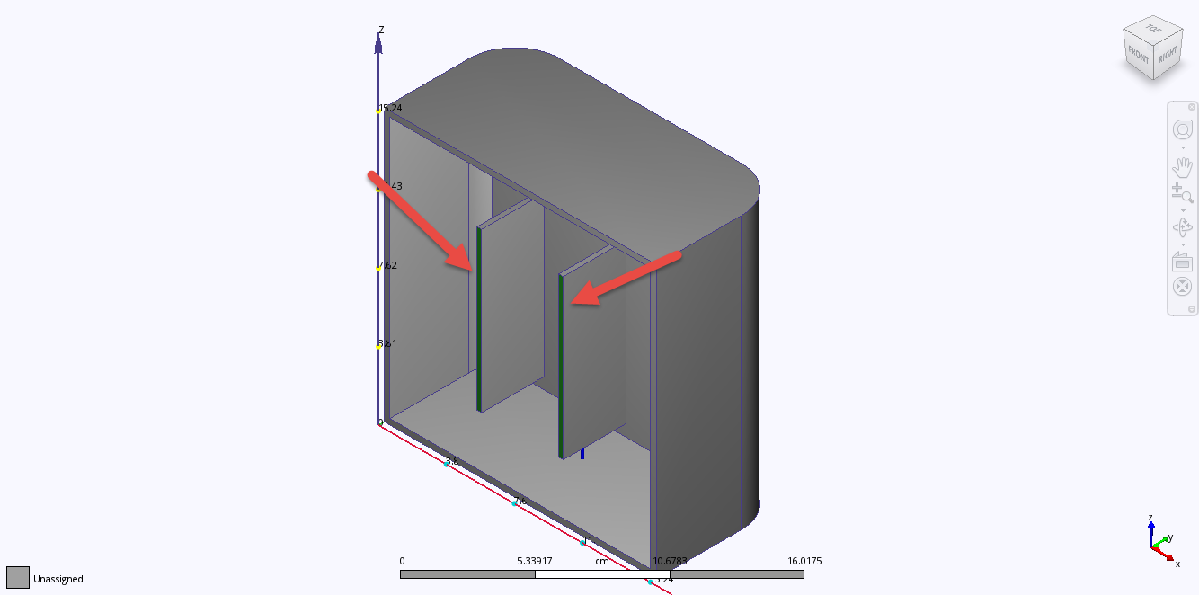

  5. Rotate the model using the top right corner of the view cube
    The model orientation should be as follows:

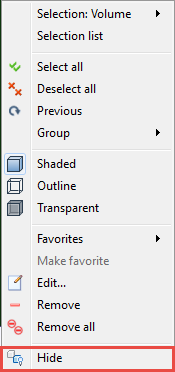

  6. Right-click on the housing and select Hide from the context menu:

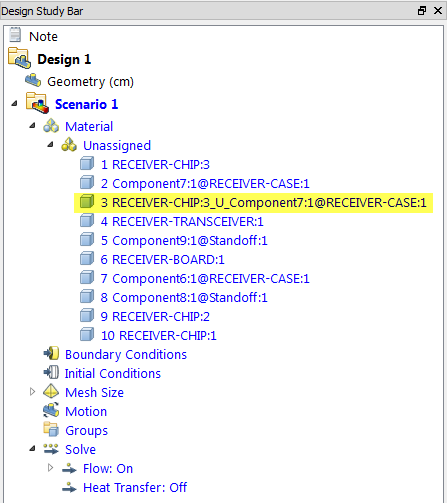

  7. Click on the right side of the Design Study Bar and pull the window to see the full part names, as shown:
    Note: Notice the part name of Volume 3 is formatted as the name of the first and second volumes with _U_ between them. That naming format shows that it is a volume created from an intersection.
  8. Select Volume 3 in the design study bar.
    Note: It is typically not intuitive what materials should be assigned to a part created by an interference. Meshing errors can also occur due to these small volumes.

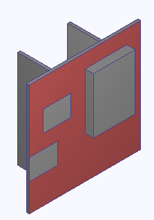

  9. Hide all of the small chips using your preferred method. The model will be similar to the following image:

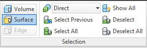

  10. In the selection section of the ribbon, select Surface.
  11. Select the largest surface on the top of the board.

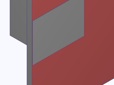

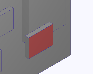

  12. Scroll the mouse wheel to zoom in to the imprint left by the lower left chip.
    Note: The imprint created during the launch creates a small sliver on a large surface.

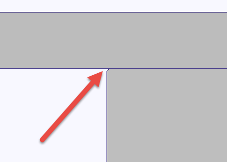

  14. Scroll the mouse wheel to zoom in towards the large chip.
    Note: The small chamfer on the chip is both a sliver surface and a small gap that the fluid will occupy.
