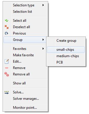

Set the Selection Mode to Volume from the Setup tab.
On the Graphics window, right click and select Group. Select the Small Chips group.

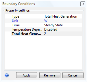

Open the Boundary Conditions quick edit dialog in ONE of the following ways:
Type = Total Heat Generation
Units = W
Total Heat Generation = 2
Click Apply.
