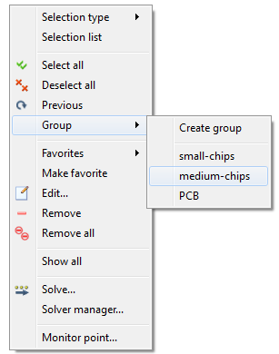

On the Graphics window, right click and select Group. Select the medium chips group.

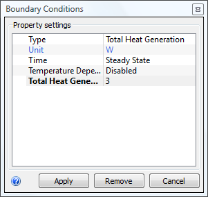

Open the Boundary Conditions quick edit dialog in ONE of the following ways:
Type = Total Heat Generation
Units = W
Total Heat Generation = 3
Click Apply.
