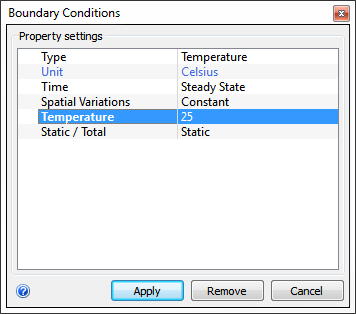

Open the Boundary Conditions quick edit dialog in ONE of the following ways:
Type = Temperature
Units = Celsius
Temperature = 25
Click Apply.
Note: If this was a transient study (diurnal heating), the sky temperature would likely be defined as a transient boundary condition--hotter during the day and colder at night.
