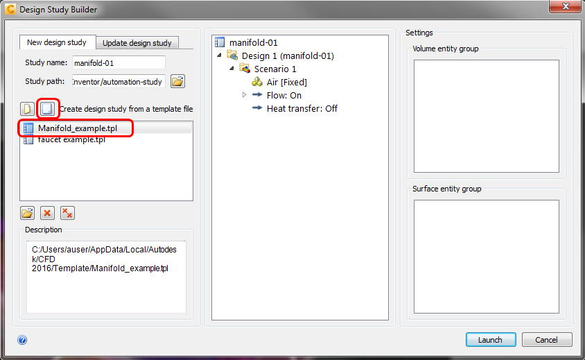

Select the four designs, and click Launch.
Note: As each design is written to the Design Study Builder, it appears in the CAD tool. This process may take a few minutes.
Click the Create from Template icon, and select Manifold_example.tpl.
