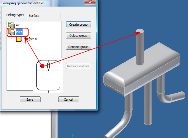

Note: Create the Inlet group:
Click the CAD Entity Groups icon from the Autodesk® CFD panel.

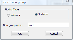

Click Create group.
Select Surfaces. Enter "Inlet" for the group name.
Click OK.
Click the inlet group, and select the inlet surface.

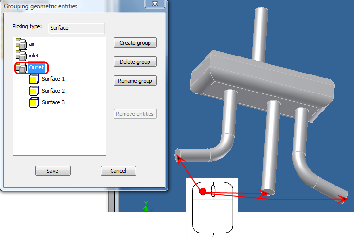

Note: Create the Outlet group:

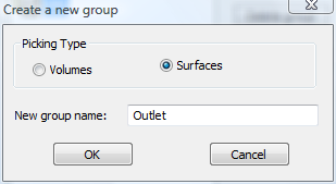

Click Create group.
Select Surfaces. Enter "Outlet" for the group name.
Click OK.
Click the Outlet group, and select the three outlet surfaces.
Note: You may have to rotate the model slightly to select all three surfaces.
Click Save.
