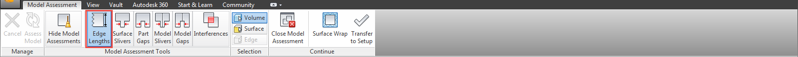

  1. Select Edge Lengths in the ribbon at the top.

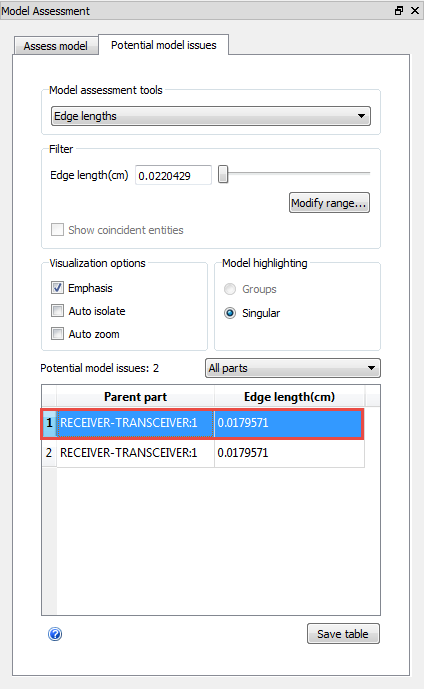

  2. Select the first edge length in the list as shown here:
  3. Select the Auto Isolate checkbox .

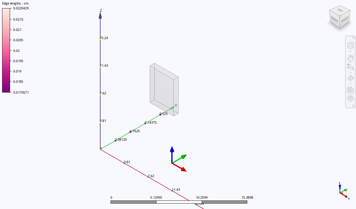

    Note: The graphic area should now only show the large chip similar to:
  4. Select the Auto Zoom checkbox.
  5. Manually zoom out by scrolling the mouse.
    Note: We can see that there is an accidental chamfer on this chip. Selecting the other small edge will zoom us to the other short edge created by the chamfer.
