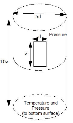

Device is Suspended Near Ceiling
Note: This is sometimes referred to the "hanging" configuration.
Modeling Considerations
Construct a cylindrically shaped calculation domain that surrounds the device.
An approximate guideline for the cylinder height is 10 times the vertical dimension of the device. The diameter should be 5 times the width of the device.
The cylindrical surface should be divided vertically at approximately the same location of the device.
Boundary Conditions
Top: flat surface of cylinder, leave unspecified
Lower cylindrical surface:
Upper cylindrical surface
Bottom Surface of cylinder (flat surface)
